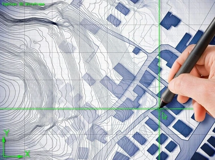

Common Mistakes to Avoid in Map Printing
AEC professional making notes on a topographical map
Overcrowded Layers or Faded Contours
The strategic use of layers is the best way to counteract information density. When too much data is presented at once, it all becomes harder to read. Having various versions of the map with various layers enabled helps display only the most important information. Be sure that the layers you choose have distinct enough line weights and colours that a little fading won't impact readability.
