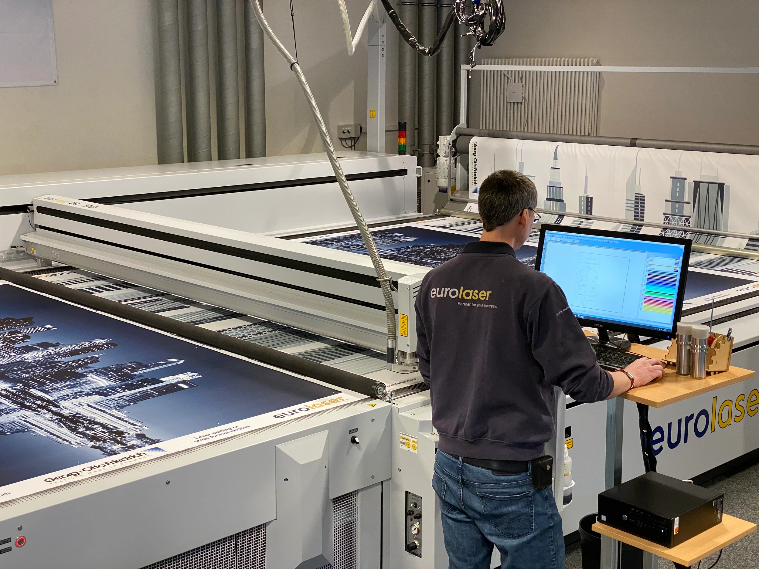

industries. With the new, optional camera system, called POSITIONplus professional,
eurolaser picks up on this trend and offers exciting competitive advantages especially for
processors in the printing industry.
Many applications require precise cutting to existing fiducial marks or other material references. For this purpose, eurolaser offers a smart solution consisting of a camera and evaluation software. Using reference points, the optical recognition system allows printed materials to be cut out precisely along the print contour. The new camera technology considerably reduces the time needed to read in the fiducial marks. The entire working area is quickly captured via area scan, thus optimising the process time. In addition, this process expands the range of possible applications. For example, contours on materials can be detected, whereupon suitable cutting data is created under software control. Pattern matching is also possible. Material patterns are detected so that the positioning of the cutting data is done taking the pattern into account. Useful functions that save time and money in further processing.
